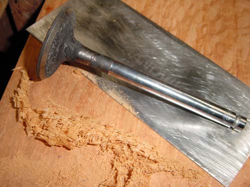

Scrapers, scraper planes, cabinet scrapers, curved scrapers, thick scrapers, thin scrapers, big scrapers and little scrapers.
Learn to turn a good hook for the job at hand and use them well. When using a scraper your not making or breathing dust, and given the very toxic nature of some of the timbers we use in this craft, that is reason enough to embrace this simple, but amazingly affective "old school" tool.
IMHO if you don't learn them, you are robbing yourself and your work. I think it is safe to say that all who have come to terms with this simple plate of tool steel never leave them to rust.
Also IMHO, if one works with a lot of high figured wood, again I think it is safe to say that they will be forced to come to terms with burnishing a hook on a scraper sooner or later.
Sandervik/Bacho do a good'n and the most EXCELLENT burnisher is free, just ask an engine re-conditioner for an old cylinder head valve stem from his scrap bin and your in business.
Scrapers = Big back ache, least heart ache.
